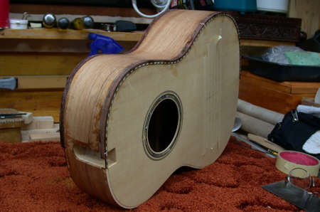

PostPosted: Sat Sep 16, 2006 3:29 pm
Great little plane, Todd. Something I'd sure like to add to the plane shelf!
I don't have another web page put together yet, so here are some photos of the last coupla days' work.

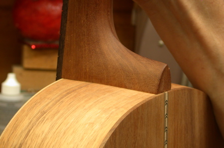

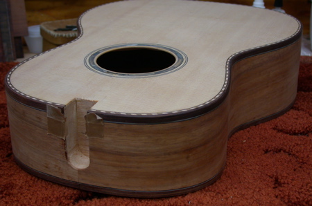

Finished up the neck fitting.

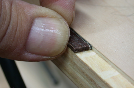

Bending the home-laminated Mad Rose binding.

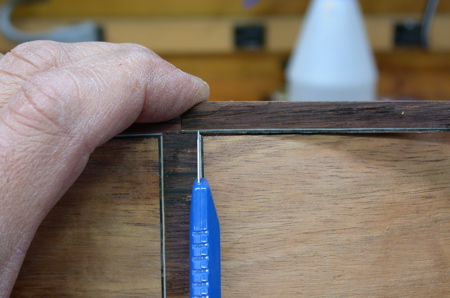

Checking the fit on a piece of scrap.
Scoring before routing with a gramil.

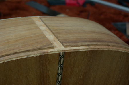

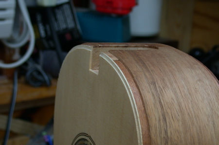

Channel routed.
Endgraft routing is done.

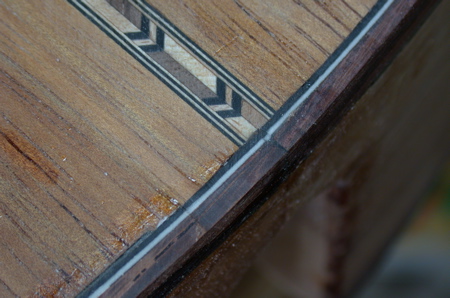

Marking the side purfling for miters.

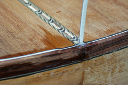

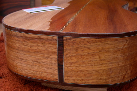

Against my better judgement, correcting an over-short side purfling strip.
Guess it was worth the effort. It's hardly noticeable from a normal distance.
The tape-and-CA-with-acclerator really made a mess of the top and back. Lots of cleanup will need to be done. Wood bindings sure are a lot harder than celluloid!
Cleaned up pretty well.
Gotta love that z-poxy! The end graft is BRW, which happened to match the Mad rose bindings pretty well.The miters turned out just OK, but they were my first and I'm a happy camper!
I'll post more pics as she progresses.burbank38977.0595486111

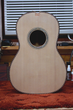

Thanks, guys! Now that I have the purfling on, I'm wondering if it's a bit too much on such a small body. I think the smaller rope purfling, such as Karin Rost has, might have been better. Overall, I'm pretty pleased.

I like the purfling, it's not too much, it gives a bit of the old fashioned feel to it. Cool.SteveCourtright38977.5743287037
PostPosted: Sun Sep 17, 2006 1:10 pm
I usually dislike overstated appointments, but I must agree with Steve on this one. Your purfling looks great!
You're really good at this documenting thing. Get several more guitars under your belt, and think about offering a print version of "Guitar Building with Pat Foster!"

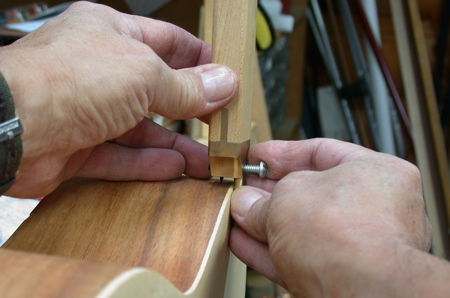

BTW, what about that extra screw in your cutter? Is it there to stabilize the blade or to help moving the cutter itself?
PostPosted: Sun Sep 17, 2006 1:21 pm
Thanks for the comments, Carlton! I find that the steps I take in setting up the shots causes me to slow down and think more about what I'm doing on the guitar work. The "extra" screw came about when I was adjusting the gramil and found one of the small allen set screws missing. The big screw that you see is its replacement, which it turns out makes the tool very much easier to adjust than the original, which requires juggling two allen wrenches at the same time. Turns out the lost screw had actually fallen into the inside of the tool and wasn't missing, but I liked the new arrangement so much better I never put the original one back in. burbank38977.9320138889
